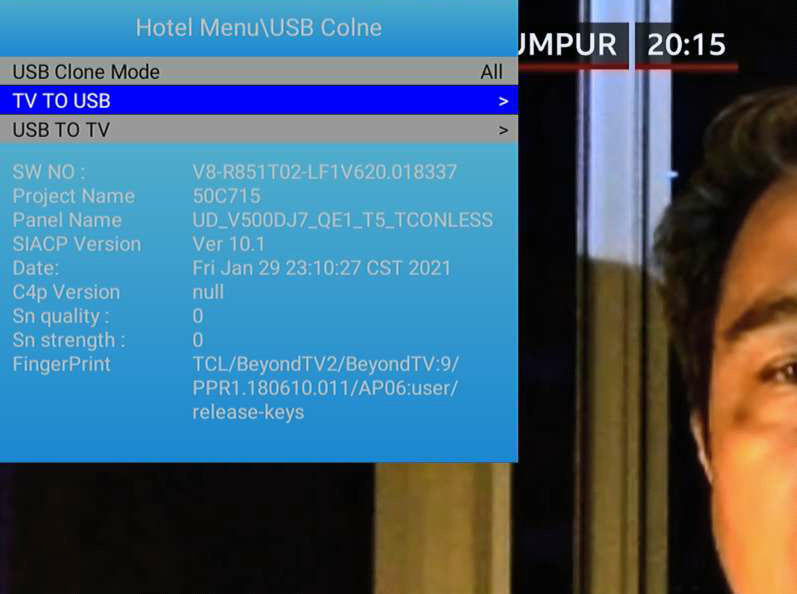

stasio a écrit:0915...nothing !
1950 (6405)...ok
Hotel USB Clone..?
Need to enable Hotel menu first...is disabled.
Edit:
Tried......but nothing on USB...empty !?
Yes 1950 sorry.
Via FACTORY MENU → USB Clone ** not HOTEL MENU → USB. Mea culpa.

Message » 05 Fév 2021 14:44
1950 (6405)...ok
Hotel USB Clone..?
Edit:
Yes 1950 sorry.
Uhh...Hotel menu done....
Now I must disable Hotel menu first ,then try again....in Factory menu.... :)
Don't worry...I will do... :D
ok....Factory Menu
Take note that my Project ID not same as your (probably).
Send PM.....

Message » 05 Fév 2021 15:04
I noticed that you have a "50" TV, my TV is a "55" slightly different panel, but your file at least moved me to fix the color settings. So thank you very, very much. At least the color adjustment now works, thanks to you.

Message » 05 Fév 2021 15:17
S-KERNEL a écrit:I noticed that you have a "50" TV, my TV is a "55" slightly different panel, but your file at least moved me to fix the color settings. So thank you very, very much. At least the color adjustment now works, thanks to you.
:bravo:
Yea,
50" has different TV panel then 55"....
C715
50" QLED.......TV panel model InnoLux V500DJ7-QE1 T5 (Taiwan)
55" QLED ......TV panel model CSOT ST5461D12-4 (China)
65" QLED ......TV panel model CSOT ST6451D02-G (China)
Hope files helps you..... :ohmg:
